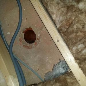

    How do I connect into this soil pipe?
    I understand. Thanks for taking the time to explain. You've helped me a lot thank you!
    Thanks for the answer. What about where the pipe goes through the plywood floor? Is it fixed using a flange or something? Ta Paul
    Can anyone help me please? Having a bit of a nightmare fitting a new WC. I have added a picture of an old toilet waste that I need to connect into. It is clay and concreted into the floor. It did used to have a collar on it but it cracked and came off when the old toilet was removed. A...
