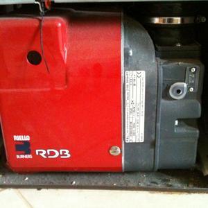

    Help please - Boiler lockout...air?
    lol not so good as my partner said the plumber said he will drop an invoice in next few days eeek he didnt actually do anything!
    hhhmmm the stick can be dodgey as our stick was reading a few inches when the boiler went on lockout. My OH knocked on a plumbers door up the road and said we could not afford a call out fee but could he come look and he did and told us how to bleed it and its all working now. He said just what...
    We cant all be perfect! I was monitering the oil level but with it being -15 i was trying to get the most out of it and our sight guage was wrong. Thank you to the other poster
    I have searched the forums and found a few threads but none i can easily relate to too my pump. Thanks
    Hi We ran out of oil at xmas time and unfortunatley i left the boiler running and it went onto lockout. We turned it off as we could not afford oil. We have now just had some delivered but when i press the reset button the boiler starts up with power but dosn't fire up. I have heard there is...
