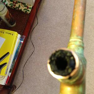

  3. T
    problem with CH
    Finally solved the problem - ran a magnet over the pipework and found this -

    problem with CH
    Sorry to bring this back up, and thanks for all the responses. Still no joy, and my mum is now in hospital for an operation so I am going to have another go at sorting it. I have fitted a gate valve in the flow to the HW but when you open it a small amount that still causes issues with the CH...

  9. T
    problem with CH
    Hi I would be really obliged if someone could help with the following problem with my mums central heating - she was having problems with air getting into the system but this has now been solved, the problem now is that when HW is selected (and heating), the HW works but the CH stops. I have...
