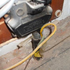

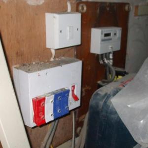

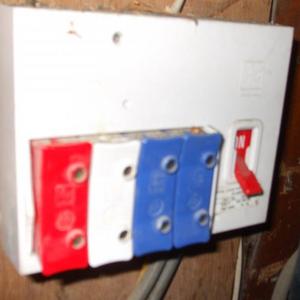

    new consumer unit what should I buy mcb's rcbo's?
    I am going to ask a sparky to come in and change my consumer unit question is should I be looking for a unit running all rcbo's, a split load or rcd unit. I don't confess to know to much about this so your thoughts please on what would be the best. At the moment I have 1 ring main and 1...
  7. T
    1 ring main
    Thanks for all the replies Ban-all-sheds, There is a earth bonding running from the fuse box under the floor to the incoming water and gas services. Is this what you were refering to when you were talking about bonding? when i have the new consumer unit installed should i also have an...
