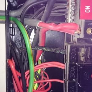

    I've uploaded pics to my album if you know how to look there?

    I checked the voltage as you mentioned. Getting 5V between live/neutral and live/earth. 0V between neutral/earth. This was regardless of if the fuse was in or out. I then opened the fuse box and found the connecting with to the shower fuse to be burnt from the fuse upwards for approx 4...

    I've been trying to help a friend with their electric shower but cannot find the solution to the electric shower not working. I started with the fuse which was fine. Next I looked at the shower unit and there was only 5V on the supply side of the shower. Next I tried the shower pull switch...
