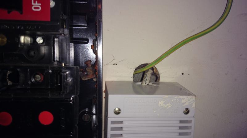

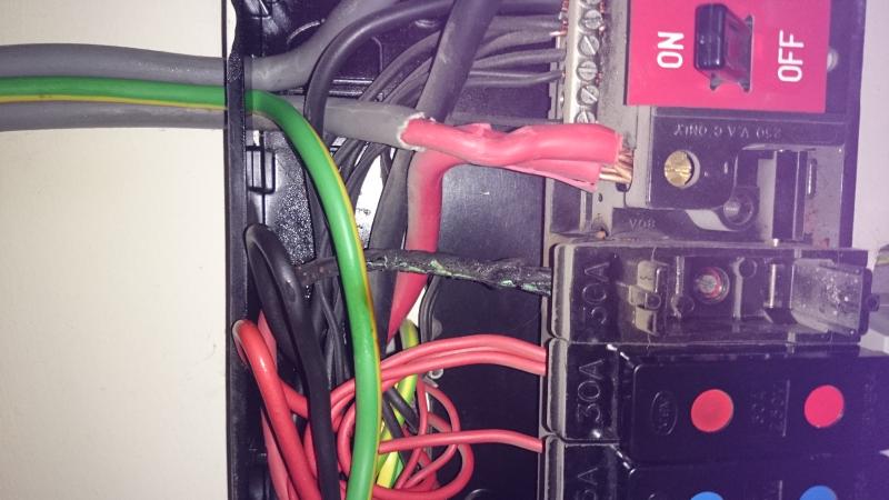

I then opened the fuse box and found the connecting with to the shower fuse to be burnt from the fuse upwards for approx 4 inches. There is also something metal lying below the fuse that looks like it has come off and may have caused a short burning the cable. Strange why the fuse never went though. I'm going to leave it to someone more qualified than me to resolve now.

looks like either the terminal in the fuse holder has come loose and burnt out through arking or the same has been caused by loose conductor or a bit of both. You will at best require new fuseholder and the cable making good.
You'll be needing more than a fuseholder.
You need a replacement CU.
That looped feed from the incommer with the slashed sheath looks "interesting" :eek:
