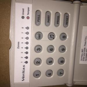

    Veritas 8 alarm tamper red light
    Not sure where to look at to review the basic log but I pressed omit on the keypad and nothing happened. I have attached a photo of the keypad and the tamper light on. http://www.diynot.com/network/tpurce/albums/

  6. T
    My alarm went off a few weeks back when I accidentally entered the incorrect code and the alarm went off. I put the correct code and unfortunately the tamper light will not go off. I have tried to reset and also followed the steps in a separate forum discussion where it recommended to remove...
