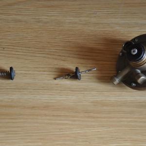

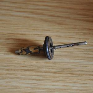

  4. T
    Sime Frindly format diverter valve
    Ok its working now!!! after a strip and clean and back together as above both DHW and CH are working! Thanks for the diagram, that helped allot!

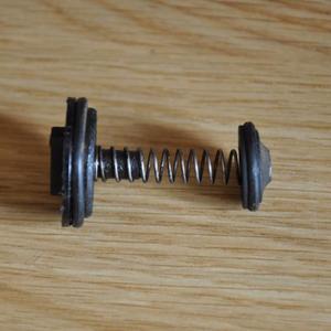

  5. T
    ok I have again stripped it down and here are a few new pictures to show how its currently going back together the part with the spring goes in from the other side of the plastic manifold
  6. T
    ok, I have put it back together as the above, I know have CH but no hot water! wtf!

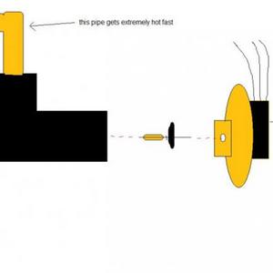

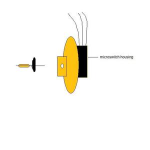

  7. T
    that is extremely helpful, thankyou! it looks like I have put it back together slightly wrong, argh!!
  8. T
    Basically I took out the following parts Diverter valve (replaced diaphragm) http://www.discountedspares.co.uk/images/cache/2f78cf5d1a713953bf682ae0a6192c33.jpg And also removed the heat exchanger and cleaned out The hot water now works but the CH doesn't, the boiler fires momentarily...
  9. T
    I've re read what I put Tony! I meant there is now no CH!!! Apologies!!
  10. T
    Sorry Tony I maybe didn't make myself very clear. I put the diverter valve back together but where you push it back into the plastic body there is a pin with a small cylinder that sits in the valve. Pressumably to push the pin inside the valve itself to activate the switch. Does that make...
  11. T
    Hi guys I have just changed the diaphragm on the diverter valve on my friendly format due to no hot water, hot water is working excellent now however.... I have now found I have no hot water? I can only think I have put the plunger in that controls the diaphragm? its like a spindle/pin with...
