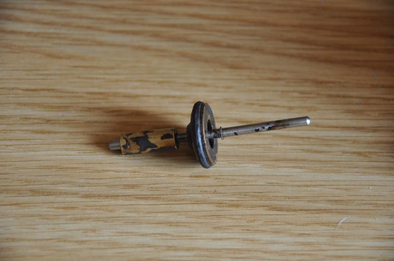

Hi guys
I have just changed the diaphragm on the diverter valve on my friendly format due to no hot water, hot water is working excellent now however....
I have now found I have no hot water? I can only think I have put the plunger in that controls the diaphragm? its like a spindle/pin with a small o ring, a metal cylinder and like a small plunger, stupidly I didn't look how it came out!
Can anyone advise the combination of how it goes
This is my Valve: (6281504)
http://www.discountedspares.co.uk/images/cache/2f78cf5d1a713953bf682ae0a6192c33.jpg
Thanks in advance
Matt

The spring goes at the switch end and the diaphragm goes so the spring sits in the appropriately shaped place.

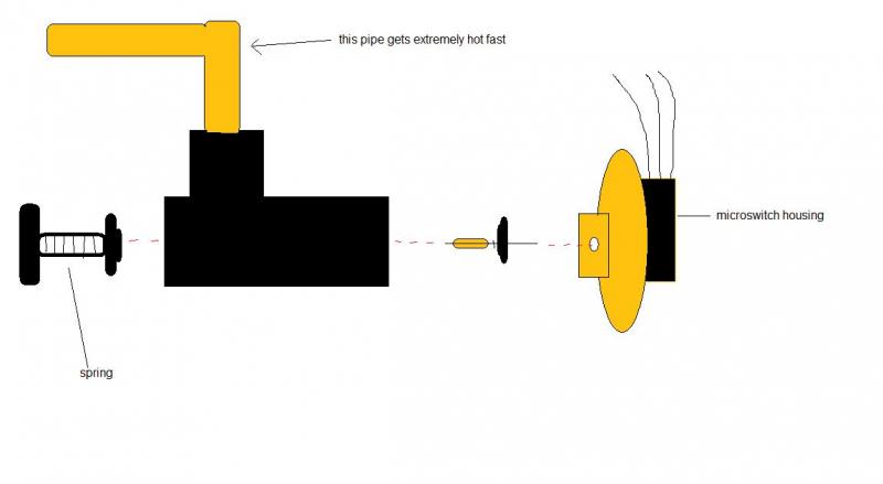

I put the diverter valve back together but where you push it back into the plastic body there is a pin with a small cylinder that sits in the valve. Pressumably to push the pin inside the valve itself to activate the switch. Does that make any sense at all?
I may have to draw a picture lol

Basically I took out the following parts
Diverter valve (replaced diaphragm)
And also removed the heat exchanger and cleaned out
The hot water now works but the CH doesn't, the boiler fires momentarily seems to overheat extremely quick (doesnt get to the CH pipe) then cuts out (the pump continues to run)
I'm concerned that when replacing the diverter valve I have replaced the pin incorrectly or in the incorrect order and I cant find an exploded diagram to confirm this
here is an image of the pin i was talking about and thats how it went back in? is that correct? also thats the pipe shown below that gets very hot
Apologies for the terrible paint skills lol
Thanks for any help, very much appreciated
This is NOT your diverter valve, but this part of it might well be the same.
The greyed-out bits you won't have removed.
If you've lost the little metal circlip, dead centre, it won't do what you need!
You should b able to work out the 3 pipes from the DV
1 comes from the main heat exchanger
1 goes to the tap water heat exchanger
1 goes out to the rads
that is extremely helpful, thankyou! it looks like I have put it back together slightly wrong, argh!!
are you sure you put the spring the correct side of the diaphragm? if you haven't I will not move the pin out! :D
Ok its working now!!! after a strip and clean and back together as above both DHW and CH are working!
Thanks for the diagram, that helped allot!
