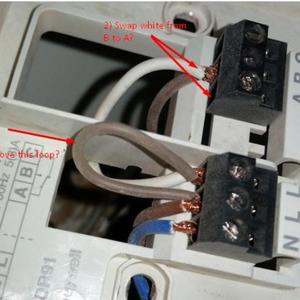

    Vaillant ecoTEC 831 with Timerswitch130 and Honeywell DT92E
    I made these changes, and it didn't work. The boiler wouldn't fire anymore. It almost feels like the boiler is getting its power from that L-B loop. Is that even possible? to have a boiler powered from the boiler control? The test was - apply changes as suggested here, run up the temp on the...
    Thanks very much for your responses chaps - very helpful. Can you double check the changes in the image above? If I make the changes 1) and 2) above, that will mean I can take out the TimeSwitch and use the honeywell to control when the boiler turns on or off right?
    Here is my current setup. The Boiler front And the thermostat back plate. It looks like I have some sort of loopback between B and the second L, and from L to L. No idea how the colours correlate to the letters though, or which colours mean what coming from the boiler...
