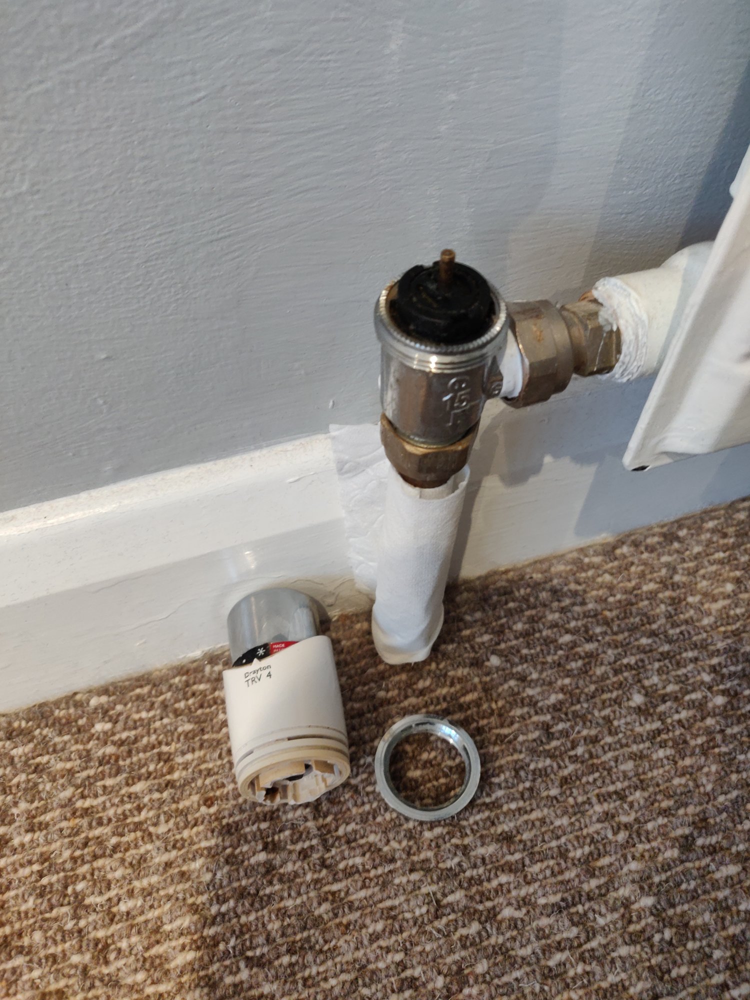

    Anyone know how to salvage this? looks like the screw thread part of the plastic is left inside.
    I _really_ dont want to drain the whole system for this.
    Please let me know if anyone can help with ideas on how to get the plastic out. I'd like to just buy a replacement head and pop it on.
    Thanks in advance.

    Unscrew the ridged ring and replace the head...although given the spindle condition it might be more prudent to buy the complete valve and just use the head for now.

    As Gasguru says + press the spindle down to see if it moves - don't pull it out. Looks like the leaking spindle has released something that has attacked the plastic

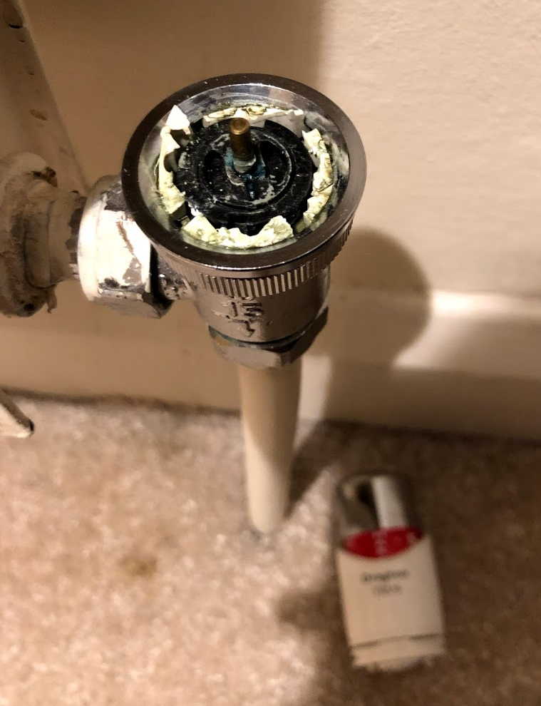

    I have the exact same thing in my house. I have no less than 3 of these Drayton TRVs in exactly the same condition. 2 of them have been broken for a couple of years but are in rooms where I don't need to adjust the temperature.
    I just went to fiddle with the one in the bedroom which broke recently (as I want to turn the heat down) and tried to turn the spindle. It didn't really do anything. Worryingly I noticed that if I turn the black plastic thing at the bottom of the spindle it leaks a tiny bit of water (so i turned it back!)
    It's like the the heat causes the plastic to become brittle and eventually snaps. Not a great design!
    I think I am going to try and survive through winter and then drain the system and replace them all in the spring.

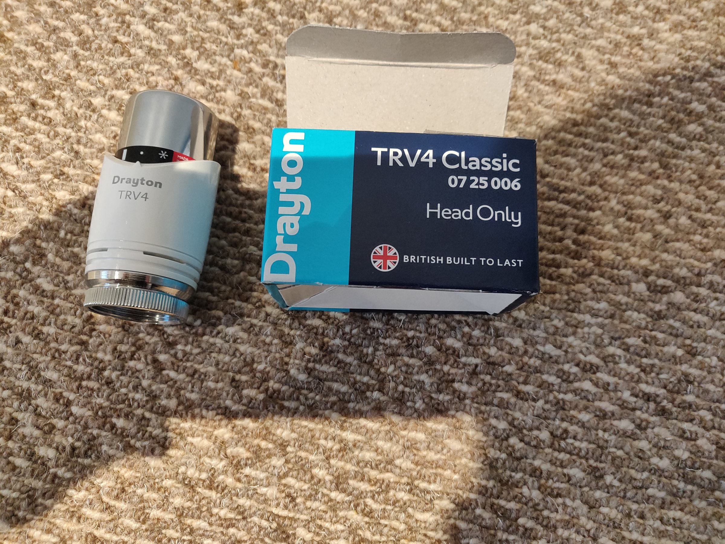

    Thanks for the comments, I didn't realise that it could just be screwed off from the metal part, I thought I the screw was in the plastic part.
    Did that head only come with the Drayton key? did it also come with any spare values?

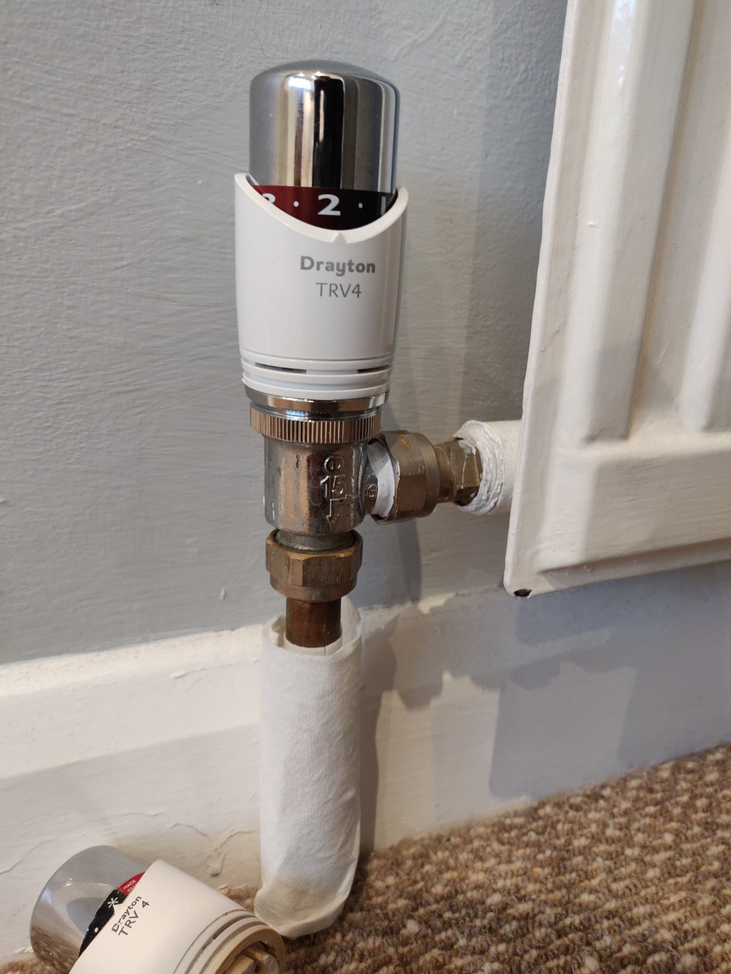

    The head came with nothing else. See photo:
    I simply needed to unscrew the old silver ring, screw on the new head (setting to max heat to make it easier) and job done! Took 5 minutes.
    I've turned it right down to off now. Once I confirm that it has done the trick and the radiator is cooling down, I'm going to buy another couple of these for my other broken ones.

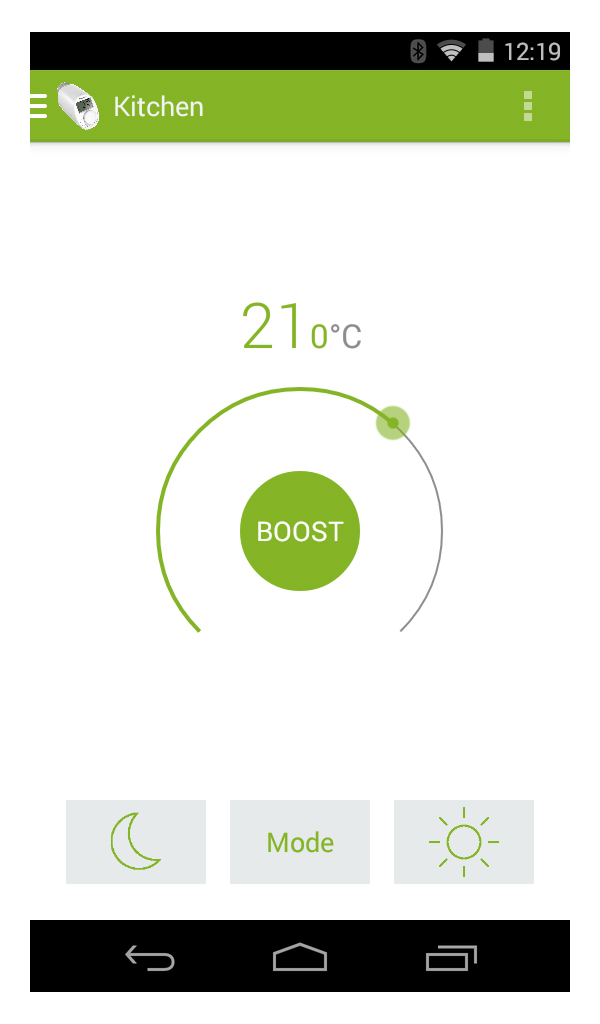

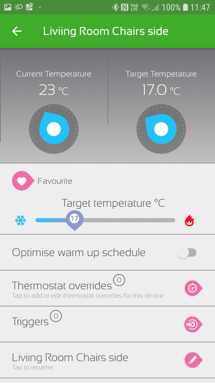

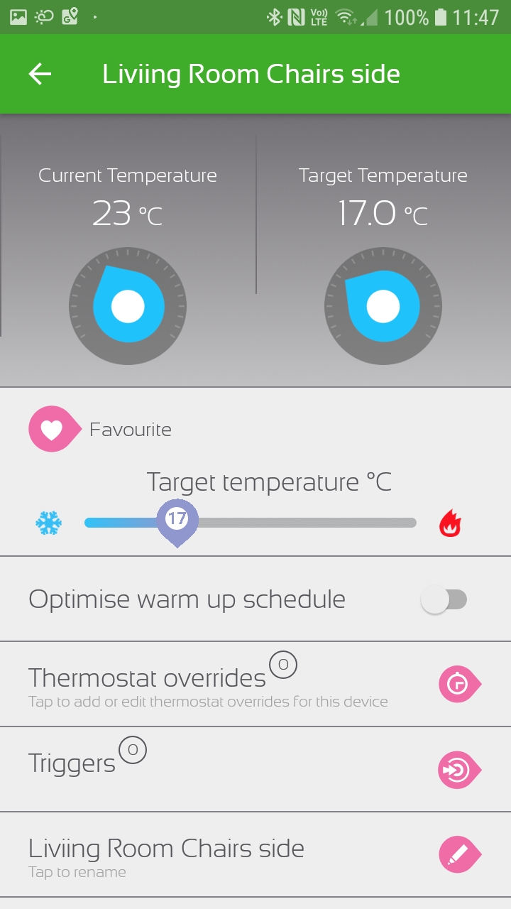

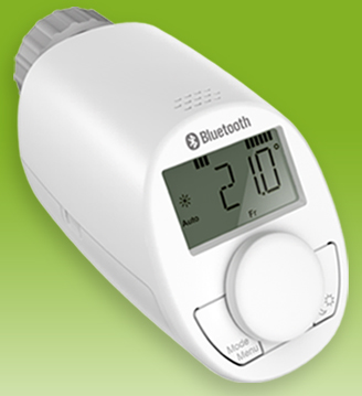

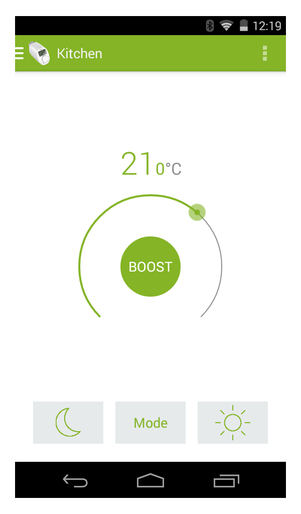

    I had the same problem, what I did was compare target to current once the system has been running for some time, if target is below current then close the lock shield a little, and if target is above current then open the lock shield a little. However to do this clearly you need electronic heads which report both target and current temperatures. Screenshot_20190725-114727_MiHome.jpg With cheaper TRV heads it only shows the target, 510VC3xAYwL.jpg so you need a thermometer to get current, I have found thermometers can give up to 10°C different readings depending on where placed in the room, in my living room at this time, windowsill above radiators shows 18.3°C and the two TRV heads show 19°C and 20°C with target at 19°C since the TRV has 1°C increments that's about as close as one can get. So put a thermometer some where near the TRV so should be around the same 61dmtMm13BL.jpg air temperature and do some trial and error adjustments until you know if the TRV reading is accurate, the TRV head shown has an offset adjustment ± 3.5°C where the more expensive heads have twin sensors one for air and one for water so auto compensate.
    I am honestly not sure if worth the extra money for expensive electronic TRV heads, because there are some features of the cheap heads like window open detect and warning if pin is either not opening fully or not closing fully which are not on the more expensive model, also being able to set eco and comfort so just press one button on starting to use room, well two buttons one to turn to comfort other to work boost 80% open on valve.
