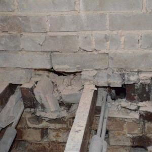

    replacing joists and sole plate
    pipe work is not an issue. These are all being re routed I have checked Build regs Tables and the spans are ok even for replacement 47mm x 97mm c16 timbers. I intend to spray all sub floor timbers while I have the opportunity. Not sure I follow your logic about leaving the old DPC in...
  2. W
    the wall plate has rotten and been bodged previously. The joists are 4 x 2 and in the adjoining rooms they are supported by sleeper walls at aprox 5ft spacing. If I were to change the joists up to 6 x 2 of greater then I would be replacing the floor level throughout or rebuilding all...
    how close can the sleeper wall be to the structural wall? The bathroom is only about 1.6m wide.
  6. W
    yes the bathroom is between a living room and a kitchen. The joists for for bathroom and living room are supported on sole plate of one wall and the opposing parallel wall supports joists for bathroom and kitchen Regards

  12. W
    I have just bought a ground floor flat and have found a problem with two supporting walls in the bathroom. GF Flat with one flat above. FF flat has same foot print and supporting walls rise to eaves level. The joist have rotten along with the sole plate which supported the the joists and...
  13. bathroom joists
    bathroom joists
    oh dear!!
