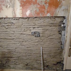

  6. W
    Internal stone walls
    @JohnD That could be. There are quite a few bits of wood scattered through the walls. I just assumed it was later additions that was done when the house was split into two properties by the council in the 60s. They are also pretty randomly scattered.

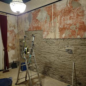

  8. W
    It does seem to pretty shot in most places, and is coming off on large chunks. If it were solid I'd happily skim over it, but it does seem like most of it will come off. It's also throwing up some surprises like random concrete, in places, lots of holes, and a few bits of newish plaster.
  9. W
    Tell 80 Sorry if I was not clear on my original post. The walls in question are the internal partition walls between rooms, not the internal face of the external walls. The internal partition walls (pictured) in this house are all solid stone, and are all dry. It is these walls that I am...
