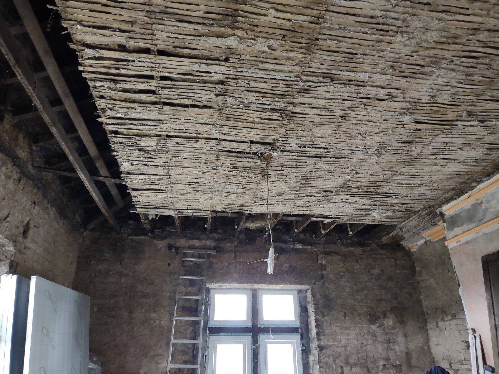

Hi all,
I am hoping to get some advice/thoughts on how to best tacking an issue with our ceiling.
Our bedroom ceiling in our Victorian house needed replacement as the old plaster was damp and falling down. I have removed the old plaster and some of the old lathe, but have noticed that the existing joists are bowed/sagging in the middle of the room. The span is a relatively long at 5300mm with old 40x95mm joists at 400 centres.

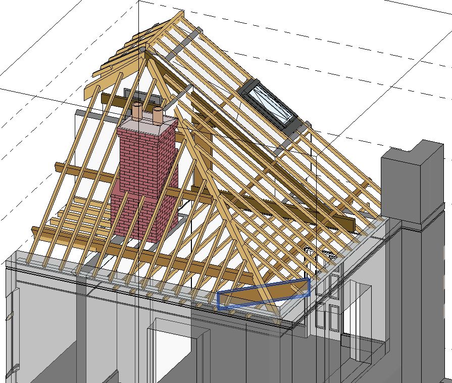

The loft space above that particular room will be used for storage mainly. Nothing too heavy. I am trying to get hold of a structural engineer to try and find a way past the tie in the attic truss I mentioned, that would give me the option of adding a bathroom, but that is an other project..
For your first option, can you clarify where the purlin would go? Would it be a cross beam running the across the shorter span? or would it be fixed to the roof rafters?
I'm tempted to go with taking it down and adding cross beams. My walls are all solid (no cavity) stone construction, what's the best way to fix the new spans and beams to the walls?
Could I not add a couple of cross beams instead of a fitch and do the same as you suggested? Still not sure how to support/hang the beams though.
Everything comes down to money these days, so firring strips is an option, but it means clearing the old lath nails from the existing joists...i feel replacing them might be easier and less messy.

A filch beam can be assembled above the existing joists as they are made up of smaller items ie a two off 6x2 sandwiching 3 off 4x2 to give 6x8 beam. its just a case of access and weight ...trying to lift and manage a heavy beam through the existing joist would be a pain.....and it goes across the joists...as does all other beams they are there to shorten the span of the joists. A solid 5m 6x8 beam weighs in at 65kg a 6x8 plank is 14kg...which one is easier to navigate through the existing joists.
So you could cut you joist in the middle and put a cross beam up and then join you existing to the cross beam with joist hangers. The cross beam is fixed to the side wall with joist hanger.
