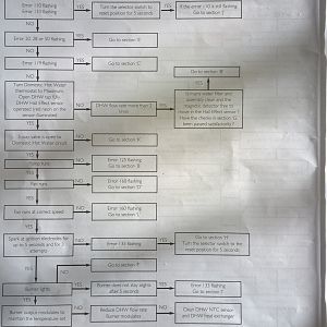

    Baxi DuoTec 24 He Hot water problem
    Just realized I hadn't updated this post! (Apologies because you guys spend your time helping us out). Baxi engineer came round and changed DHW ntc sensor and diverter valve. Said common problem because no filter fitted on heating return.Covered under warranty because problem was identified...
  2. Whizzard17
    Yep. He is Baxi registered and all services by Baxi registered engineer. Thanks for that
  3. Whizzard17
    Hi and sorry for getting back so late. Been under the weather . Ok so I have checked the heating flow pipe and it indeed gets quite hot when radiators are off. Guess I have a diverter valve problem. I'll have to check the warranty. It's over three years now. Bit annoyed really. My old Vaillant...
  4. Whizzard17
    Hi and thanks for the info.I wasn't able to check heat on the flow pipe as it's set behind kitchen units. However I did make some calculations on the gas. After 2mins,from the gas meter, there was of difference of 0.0782m^3. So divide by 2 and multiply by 60 gives 2.346m^3/hr. This equates to...
  5. Whizzard17
    Hi. Boiler is three years old. Noticed recently that on full flow - from kitchen and bathroom tap - that water does not come as hot as it should. When flow is reduced, temp increases on both so filling the bath takes a little longer! I have set the temp at 60degC and on full flow forom either...
