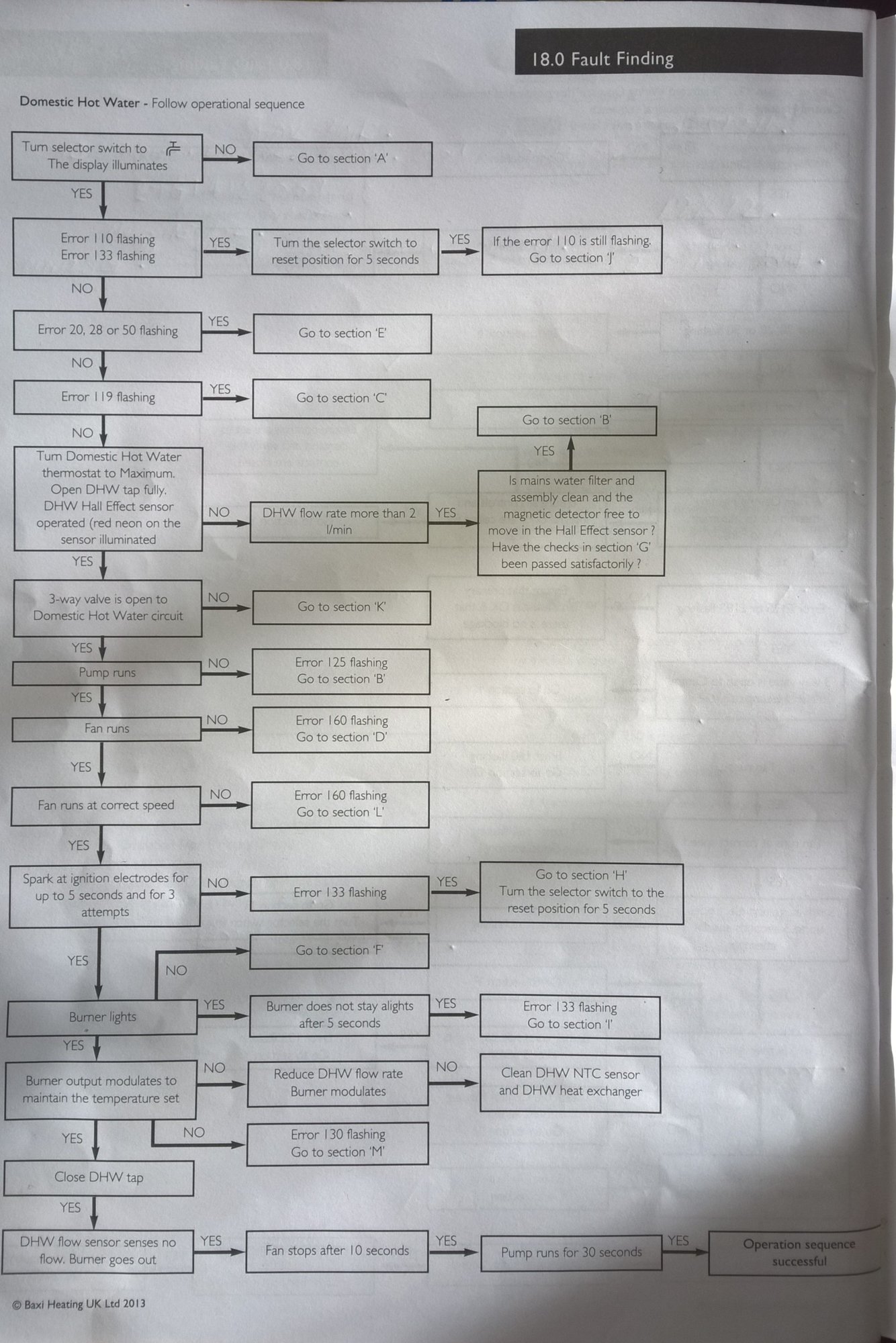

Hi. Boiler is three years old. Noticed recently that on full flow - from kitchen and bathroom tap - that water does not come as hot as it should. When flow is reduced, temp increases on both so filling the bath takes a little longer! I have set the temp at 60degC and on full flow forom either tap, but display show actual temp at around 50degC. I used a thermometer and actual temp from tap was 34degC. Flow rate measured at around11.5l/min and 10.5l/min at kitchen and bath tap respectively. (Measured with a bucket and stop watch as I don not have a weir gauge).There are occasions when the actual temp is showing 71degC but I cannot confirm the temp at the tap as only have a medical thermometer which just reads 'HI' beyond 42degC! I have gone through the fault finding in the manual and could deduce from this that it could be the NTC sensor or heat exchanger. I have inspected the heat exchanger visually and looks ok and clean. Pump and fan run and stop in correct sequence when they should do. I don't want to have to call anyone out if it's something I can do myself. I'd grateful for any help. Thanks:)

Hi and thanks for the info.I wasn't able to check heat on the flow pipe as it's set behind kitchen units. However I did make some calculations on the gas. After 2mins,from the gas meter, there was of difference of 0.0782m^3. So divide by 2 and multiply by 60 gives 2.346m^3/hr. This equates to 82.98ft^3/hr= 86297 btu/hr = 25.29kW. Manual shows gas rate of 2.61m^3/hr (over 10 minutes). DHW heat input Gross/Net are 24.7/27.4 . Output is 24kW. I guess according to these figures, everything is good However, I don't understand why when set to 60degC, the display showed a temp of 50degC but measurement at the tap was 34degC.Aside from this, all else seems logical.
