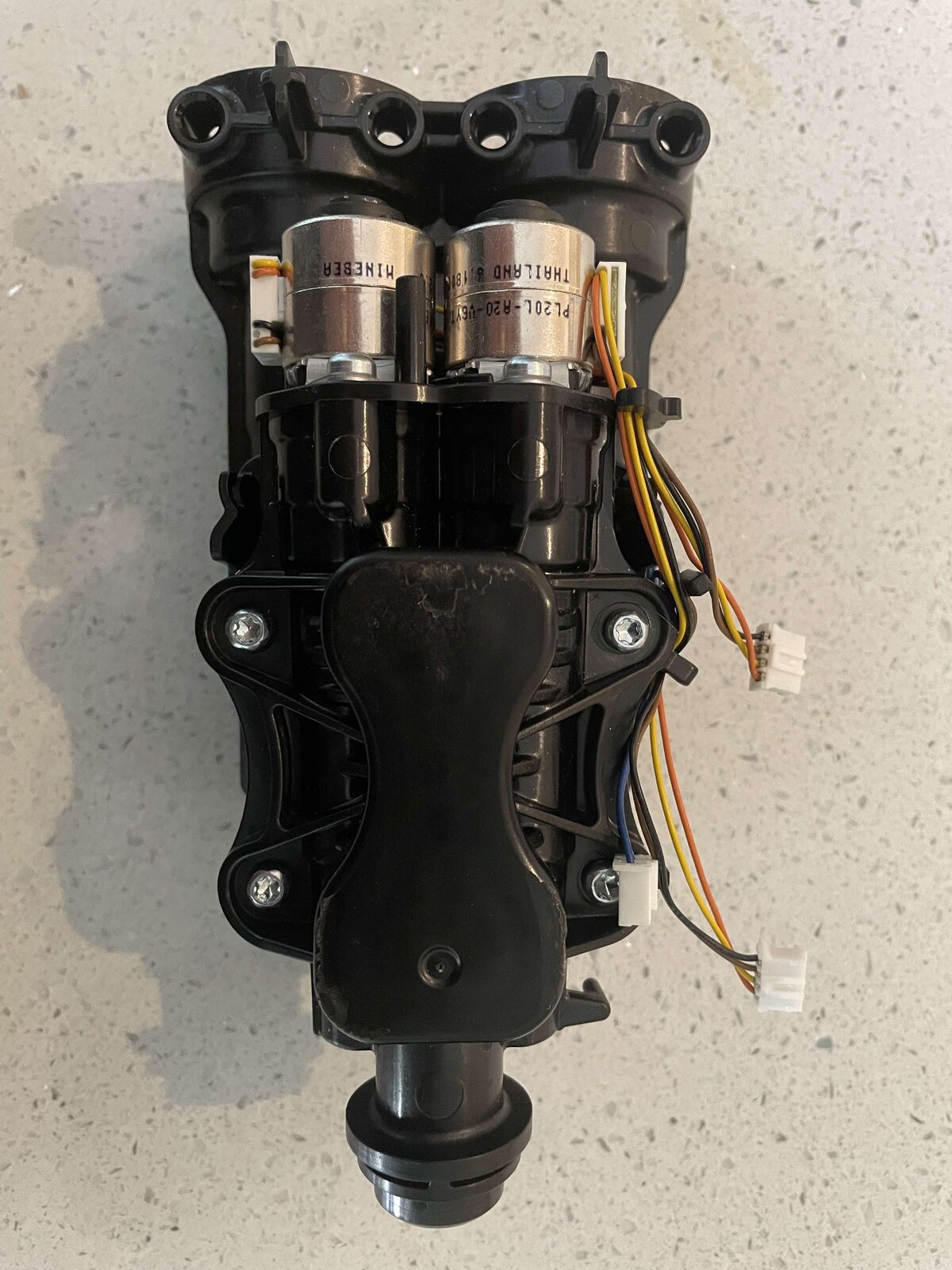

A quick update on the shower.
Mira sent me a control pcb, a primary valve assembly and a thermistor.
The valve assembly takes the hot and cold water and blends it to the target temperature. I fitted that and the thermistor.
I didn't fit the control board as it already had one fitted in January for the same fault.
Probably wishful thinking but the shower feels hotter to me, and no sudden cold shower so far.
I have done nothing with the boiler yet. From all the calcs in this thread it does appear to be under performing but if the shower is fixed I'm unsure whether to persue it.
A faulty shower thermisor might certainly cause a problem if it caused the HW to be shut off which in turn would shut down the boiler burner.
For interset, can you post a photo of the removed valve assy. as it looks as if its electronically controlled and not just the normal thermostatic type,
I can't find any ref/photo in the spares listings.

Here is a picture of the primary valve assembly. Hot water into the inlet top right, cold into top left. There is a thermistor in the hot part which looks like it can't be replaced. Valves are controlled by the two motors.
Blended water then comes out the bottom outlet into the next ducting. This is where the other thermistor is, which I replaced.
Next is a flow meter which measures the volume of water used, and finally the outlets to the shower heads.
Mine is a dual outlet so you have a choice of large fixed rainshower or hand spray. These are controlled by solenoid valves.
Everything plugs into a control circuit borad.
