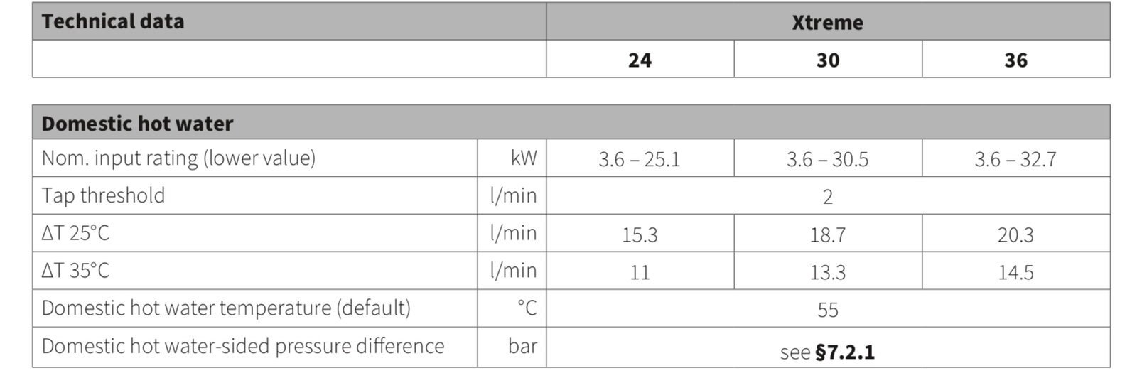

What temperature is the incoming cold main? If it’s say 10 degrees then you should be getting approx 45 degrees coming out with a flow rate of 14.5 lpm. If it’s 15 degrees, then you’ll be getting 50 degrees with the same 14.5 lpm flow rate.
So, the lower the flow rate the higher the hot water output temperature. This is the same for any combi boiler I know of.

According to the specs the Extreme 36kw has a max output for HW @ ~32.7Kw @ factory settings - under ideal conditions it should deliver 14.5L/Min @ a 35deg rise. That is the ideal output, real world temps may not quite meet those level due to external factors.
If you incoming cold water is 11deg, then the boiler should deliver ~14.5L/Min @ 46deg @ 32.7kw (MAX). As the flow through the boiler is reduced, that HW temp rise will increase. Setting the HW temp @ 65deg won't make any difference to that output temp all it will mean is of the HW output temp reaches that set temp the boiler will modulate down to maintain it.

As @Madrab suggested the boiler install manual says DHW input rating is between 3.6 and 32.7 Kw. If boiler ran at 32.7Kw (unlikely?) then the temperature in the bath should be 51.5° if my maths is correct?
