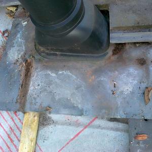

    Vaillant Flue Roof Tile
    This is what it looks like with the tiles off. Looks as if the Vaillant roof seal is already in place, but the edge at the bottom of the picture is a little low letting water into the roof space. I plan to bend the edges up and I may trim the roof tile shown here to allow a bigger...
    Hi, I've noticed a wet patch in my ceiling directly below where the boiler flue exits the roof space. I've attached a couple of photos of the flue because it looks as if there may be a specific tile missing. The boiler is a Vaillant Ecotec plus 618. The Vaillant flue instructions...
