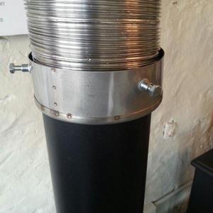

    Chimney liner question
    http://www.diynot.com/network/willismp/albums/ Hope this works? This is not my actual house, but the same adapter and flue, thanks
  9. W
    Hi, Just had a HATAS chap install a SS chimney liner and made the connection to stove. The adapter between the flexible liner and rigid flue pipe has not been sealed with anything. We questioned, he said so condensation can run down the outside of the pipe and go into the flue and then...
