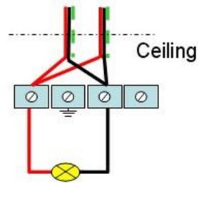

    Cannot get new light fitting to work
    Hi, I was hoping I could get someone t o help me I just purchased a new light with has 3 bulbs a connctor with Live, E and Neutral labelled Coming from the ceiling I have only 2 sets of 3 core...I connected both Earths to E both Neutrals together and both Lives together into the connector...
