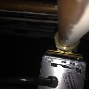

    Boiler not firing for CH - duff roomstat? Theben Ramses 811
    Hi, yes there is a motorised valve in the airing cupboard. The lever seems to be in the 'auto' position. It moves very freely up/down with no audible click or any change from the boiler end. Here's a (bad) photo :
