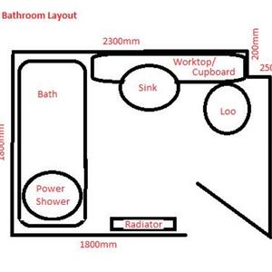

    Bathroom Refurb/Installation Layout Advice
    Hi All We are looking at refurbishing our bathroom and ideally would like to include a shower cubicle, however, we would like to retain the bath as we have a 10month old baby. This is the complication because the bathroom space isn't huge. I have drawn a diagram of how the bathroom...
