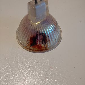

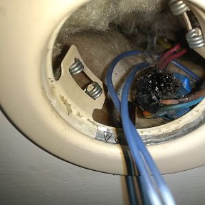

    Exposed wires - downlight
    As you can tell I'm no spark I saw your comment about 10amp, but having read up some now I understand. The lights are 50v (6amp) so as you say, 10 amp should be fine. Thanks again for your help
  2. F
    I got into the loft, looks like it's just an issue with this light, the rest look ok. For some reason only this lights terminal had electrical tape on it, which has melted. Annoying l couldn't find an enclosed chocbox in b&q yesterday (only had 15amp ones left), wanted 30amp to be on safe side...

  5. F
    Finally got round to replacing a downlight in the bathroom! I noticed scorch marks on the bulb and on closer inspection it looks like there's exposed wires in the fitting which run in to a sticky blob that I presume is electrical tape. I can't get into the loft just now, but assuming I need to...

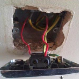

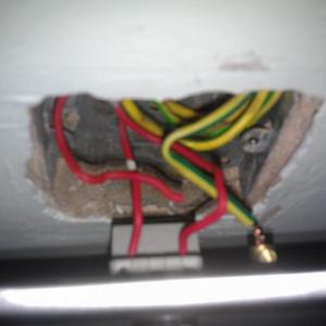

    Light switch - Wrongly Wired?
    Fixed now and both bedroom lights are working. The multimeter confirmed the dimmer had blown. With mains on I found the live wire using the voltage reader on the multimeter. I then tried connecting it to the other two to find the switch wire (light will come on). With mains off I...
    Ok I have a multimeter and understand basics I think (mains off, testing, ohms minimum resistance) I think I need to 1) check my new light switch actually works! 2) find the switch live, label and connect everything up correctly Had a look at the wiki, etc, but not sure the easiest way...
    Hi, hoping someone can help... Last year I changed a light switch for a dimmer in Bedroom 1. I thought I had wired the dimmer in the same way as the previous switch but now im thinking I got it wrong. In bedroom 2 the light went, I changed the bulb and then the switch but it still wouldn't...
