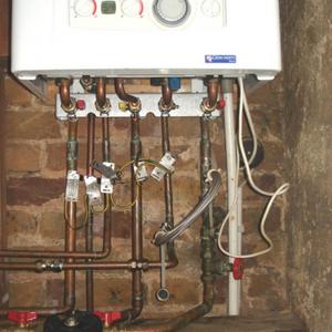

    Is it definitely a filter? If it's upside down it can't be doing much. It looks too small and thought it was a just a filling point for inhibitor etc. The TF1 is attracting debris, but loads are still getting through.

    Sorry, you mean the thing above the red valve tap? That's been there from the start, didn't think it was a filter and never be touched I believe. If I replaced it with a Spirotrap, would that work? Uploaded with ImageShack.us

    I thought that was just a valve? It doesn't look big enough to be a filter, ie a Spirotrap.

    Here's some of what's been replaced Uploaded with ImageShack.us
  9. V
    If rads are rusting inside, can anything be done?
    Here's the setup Uploaded with ImageShack.us
