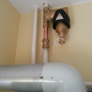

    Air separator - is ti really needed?
    Bad design ans application doesn't surprise me in this building. I've come across other crap shortcuts and bad work (put right by me). I don't think getting a vent put in will be a problem. I'll ask my local plumber - may be more than I can bite and chew...
  2. S
    Yes, 22mm all the way. Poorly designed system? As is from a new house build 15 years ago.

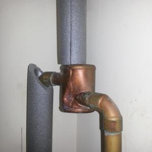

    The disaster happened this weekend, twisted the air separator while fitting a new pump. :oops: It's not leaking and I have not fired up the system, not sure if I should leave it as is or replace it. The top pipe is the feed from the FE tank - there is no vent to the FE tank, so why...
  4. S
    Twisted air separator while changing pump!
    Ooops. I only noticed after refilling. It isn't leaking but will it be OK when system is up to heat?

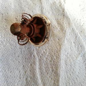

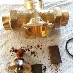

    Draining my system
    What make is your 3-port valve? This weekend I've changed the stiff spindle in my Myson 3-port valve. Of course I had to buy the whole valve to get the spindle out (so I've got a lump of brass sitting around - paper weight?).

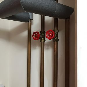

  13. S
    What type of valve is this?
    This valve is fitted to the return pipe from the HW cylinder, what is it for and why does the pipe after the valve split two ways? I'm simply interested, nothing more :)
