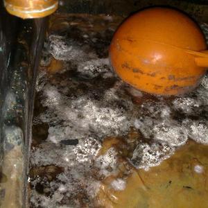

  3. U
    Mould / 'cardboard' like substance in header tank
    Hi, Just had a look in my header tank and found the following: The white bits looked like 'mould' and the brown was what I could only describe as like soggy cardboard (in texture) and about 1-2mm thick covering almost 99% of the water surface. Does anyone know what the 'cardboard' like...

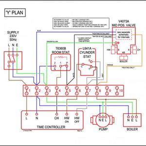

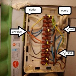

    central heating only comes on with h water, stumped engineer
    I wondered if the OP's pump was wired directly to mains but looking at a standard Y-Plan wiring diagram and the OP's wiring, if OP confirm's the pump is the cable labeled below, it looks to be wired correctly. Either way, I don't think this has anything to do with the OP's initial issue...

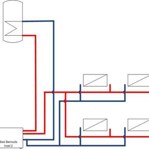

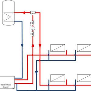

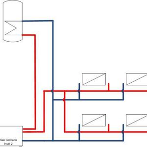

  13. U
    You have told us what get's hot at the cylinder/pump. We need to know if there are one or two flow pipes coming from the boiler (possibly the top two). The tests I mentioned on Pg16 are at the boiler side, rather than near the cylinder/pump.
  14. U
    No. Please read the 2nd from bottom post on page 16 for the tests! DIA: Could this be a possibility? Original: Changed to: (with pump running)

  18. U
    The above tests are helpful but we need to know the layout of the pipework. Without knowing how many pipes are connected, we can only guess what is happening. So, we need to identify what is connected to the boiler. Please see my last post regarding tests before reconnecting the pump. In...
  19. U
    Can you also indicate on this drawing; With the pump disabled 1) Which pipe(s) get hottest when with 3pv in HW position? 2) Which pipe(s) get hottest when with 3pv in HW&CH position? With the pump enabled 3) Which pipe(s) get hottest when with 3pv in HW&CH position? At the...
  20. U
    Mike, The OP has a Danfoss HSA3 mid position valve (as mentioned earlier in the thread! :roll: ) - The middle port is AB, the CH port is A and the HW is port B in the manufacturers instructions and on the product itself. Hmm... yes, sometimes but in this case specific detailed information...
