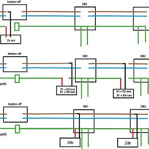

    This is related to domestic really So you have the supply into an isolator then on to two consumer units from the diagram.. Ze is at the origin ( Isolator) with the means of earthing disconnected. This supply Cable to the DB's what test on it would you perform on an EICR Now. on an EICR...

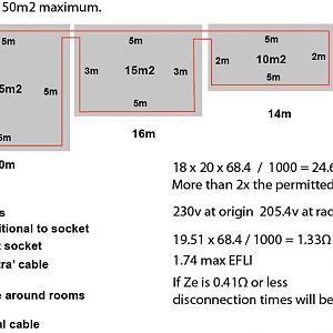

    BS 7671 Fig 15 B Historically, the floor area served has been limited to 50m2 Just re looked its in BS7671. I understand it has to be designed to its individual use, but this is simple standard circuits. You would think they would be some guidance, which I guess is what the OSG tries to do...
  12. S
    Design Current and Maximum length and Radials.
    So an A3 radial with a 50m maximum floor area. I don't see the sums working out for VD Zs is OK VD2 by studentspark posted 17 Dec 2020 at 2:35 PM

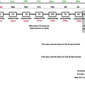

    Thanks for all the replies. Don't really understand this. So for a 20 A radial and the load on each socket is in the brackets. and the -----20---- is the load on that section of cable 20A MCB ------20---------[ 1A ]-----19-----[ 3A ]------16------[ 5A ]------11-----[ 0A ]-----11-----[ 1A...

    Just trying to calculate maximum lengths of cable for standard circuits (Just CPD) OSG tells us... A1 Ring - 100m2 A3 Radial 50m2 Now I don't find m2 a useful number, as it doesn't tell us the conductor length. Its not necessarily the run of the cable. So I thought I would use volt drop to...
