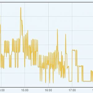

    Yeah no problem, here is the January 21st dip in closer detail. If I put both my ovens on full from cold which is a brief draw of 5.8kw I can create a drop of around a 2V to my incoming supply (but its hard to be too accurate on this given the external variation), but there is certainly no load...

    I don't think I could ever bring myself to throw away any tool, even when its well past is useable lifespan. I'm too much of a tool hoarder, much to the annoyance of my other half at times! :D One thing I do have now though thanks to my energy monitor is the sometimes debated Christmas dinner...
