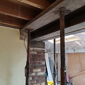

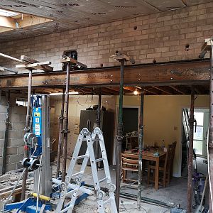

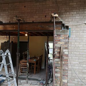

    IMG_20200904_145912 by an203888 posted 4 Sep 2020 at 7:47 PMIMG_20200904_145924 by an203888 posted 4 Sep 2020 at 7:47 PM All went OK really. Just shuttered up with ply at right level and worked to that.

    Thanks for help. I will try to take some pics when done.

    I want to cast one of my padstones in place as I can't get the right size. Searched a fair bit and a strong 3:1 mix seems the be what I need but some have mentioned using a smaller aggigrate like 10mm rather than the usual 20mm. Does anyone have any opinions on this?
