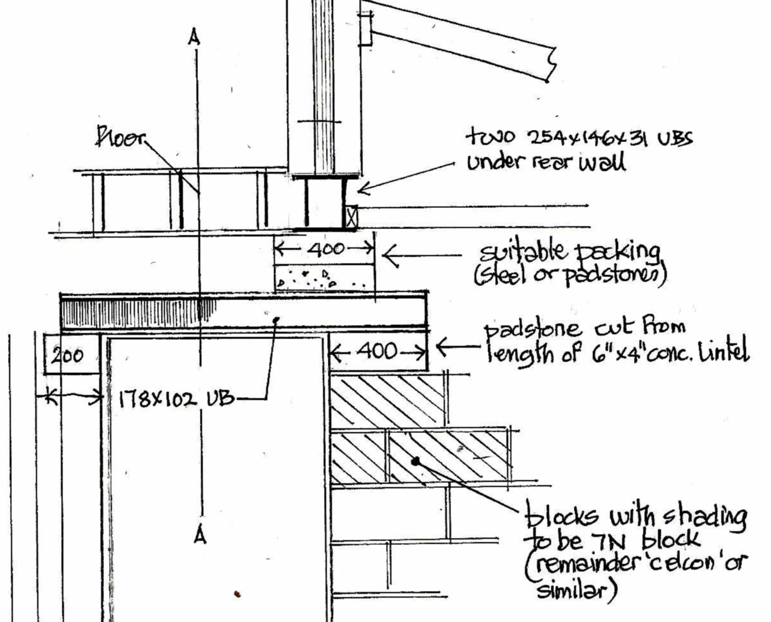

Given that you're doing something a bit unusual which needs this non-standard padstone, I would expect that you / your builder should be supplied with plenty of details about how to do the construction itself - not just the beam sizes. Tony did mine specs for me and I've got pages of calcs and diagrams detailing the exactly how the construction should be done, for example:
ps - I don't think many people on here would say to follow an architect's spec. Sometimes the feedback is follow the SE spec. Most of the time the view is that architects are 'building something pretty but impractical to build', and SE's are 'inexperienced and/ or over-engineered solutions to simple problems', more often then not people post up for help when there's no architect, designer or SE involved and they've hit a major problem...just my experience of using this place for a decade or so :D

being as tony1851 suggested you bodge it with cut down precast lintels ,most of which are c40 , lets assume a c40 spec , which you can buy bagged premixed.
This seems like a good solution, just add the right amount of water, mix well, pour, vibrate and let it cure.
Seems like a much better solution to chopping an off the shelf product to fit imo.
