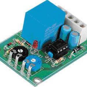

    Need a time delay circuit for my float switch and 12v pump?
    But I am not too sure exactly what you are trying to do. And is it for fun in which case yes play with 555 or is it more important in which case use a liquid control relay which has this all built in. Just want to get the job done as quickly as pos rely What is a liquid controlled relay...

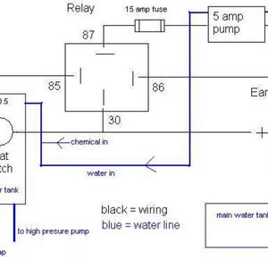

    the tkt330 Seams to be use for burglar alarms will the time intervals be regulated by the switch and not the TKT330.will it reset its self when the switch opens and closes and wear would I wire it into my schematic My schematic has a rely would I have to do away with it Hear is wear I...
    Hi I need a time delay circuit, had a look on the internet and could not find any for sale So I probably need to build a time delay circuit that when the float switch closes (opens the circuit) there will be a time delay from when the pumps turns on And/or when the float switch opens...

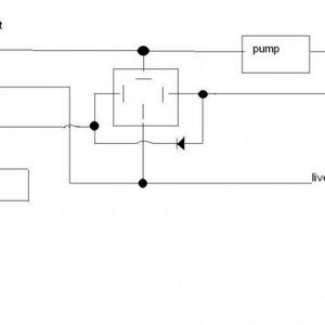

    Problem wiring float switches
    I have had the floats switches switching on and off the pump as show in the above sequence working fine Until now; I think the bottom float switch welded/arched together again and the top switch would not turn off completely (I think) only switch half off if you know what I mean Because the...
    Thank you very much everyone I have now gone and brought some diodes and fited one and the switch is now holding 15AMP Spark123 I'm from Cumbria as well
    This is my first post hear so first I would like to say hi I have 2 Float switches that operate a ‘pump in pump’ for a mixer tank on a 12V DC circuit. The Lower float switch turns the pump on and the upper float switch turns the pump off as can be seen in the hand draw diagram attached...
