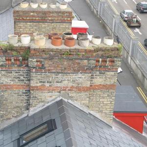

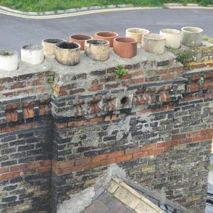

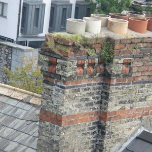

    Which pots are mine?
    Would I need chimney balloons with c-caps? They don't look like they let a whole lot of air in.
  4. S

    Am selling up and moving to SW. England. Weather here is depressing. Fitted 4"(probably too much) vents to closed chimneys and trying to make chimney balloons for other 3.(any ideas). C-Caps on all 6.
  5. S
    Drilled 4" hole where I thought the 3 fireplaces should be. Got lucky and then used smoke pellets. Problem Solved. Strange the amount of rain we get all six chimneys were dry.
    My side is the one without the 4" vent hole. You can't see from photo but it has a bulge in the middle so am taking it down about 10 rows to the 2nd, blue bricks, but only in the middle. Yes c-caps, and will vent when finished. Scaffolding alone costs £2250,-. Won't get it cheaper round here...
    Sligo. Can't afford to rebuild on my own €10.000.- + and neighbour not interested so making my side safe and repointing for €4,000.-. I have water coming in. The 3 blocked chimneys were done before I moved in (17 years) no sign of problems. Want to cap all six with plastic caps. If anyone wants...
    3 fireplaces bricked up
  9. S
    Shared chimney and I want to cap my pots but do not know which are mine. I have 3 open fireplaces and 3 fireplaces bricked up. How can I tell. see photo.
  10. Neighbour's side
    Neighbour's side

  12. My side
    My side

    Large chimney
  14. S
    Large chimney repair
    I live in a terraced Town house with a shared brick chimney with 12 pots(6 each). My side is in a bad state of repair, neighbour's side a bit better and the council has condemned the whole chimney saying it must be rebuilt from the ridge up. Neighbour has refused to have anything to do with it...
