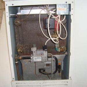

    Here are two photographs, one of the boiler and one of the header tank. The vertical pipes that are at the side of the cylinder and run up to the header tank are as follows going from the left. 1. vent 15mm 2. water feed to cylinder from header tank 22mm 3. Another vent pipe 22mm...
