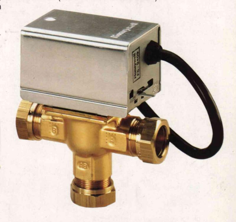

If the pump is for the radiators and the hot water, there will usually be a motorised valve like this to control its flow.
Is there?

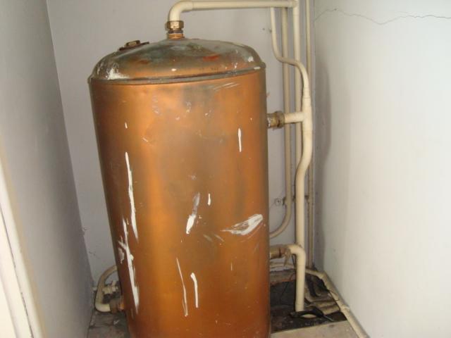

However, I have already taken a picture of the cylinder for an earlier thread //www.diynot.com/forums/viewtopic.php?p=1565058#1565058 and as the system is currently a primatic one I am therefore adding a second f&e tank and replacing the cylinder.
Here is the picture of the cylinder

That is not a primatic :idea: It`s an incorrectly piped cylinder with an annulus heat exchanger . the pipe from the flow @ the top( vent) should be 22 mm and a cold feed should go to the bottom return , in 15 mm. That annulus type will work well on gravity - better than a coil. Change the pipes and insulate it well - save money and keep it simple . ;) Just read your other thread . God knows why they didn`t fit a F+E tank in the first place :rolleyes: . that has been bodged into your 1 cold storage tank by the sound of it . You just need a proper F+E with cold feed and vent as I`ve described - IF you really want to pump it - and keep that annulus tank - then pump it from the bottom up :idea: otherwise you can get air trapped in the top of the annulus ( i like that word :rolleyes: ) and it`ll make trickling noises . Been, Done , got the T shirt:cool:
Thanks for the replies. As to why there is only one f&e tank there was a label stuck on the cylinder which although I attached photo of it to the other thread, it was in bits and therefore hard to read, but it did state on it that only one f&e tank was required.

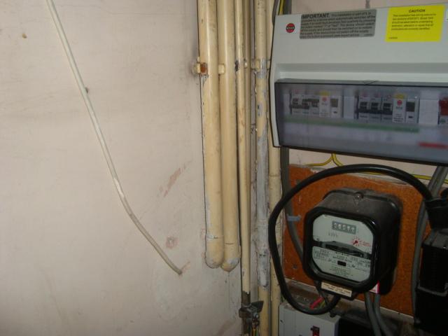

I've taken some more pictures and here they are.
The boiler is next to a cupboard and all the pipes are in there. The pipes are, going left to right, two 28mm flow and return for the heating coil in the cylinder, two 15mm main cold water pipes and then two 22mm pipes for the heating (which is a single pipe system).
