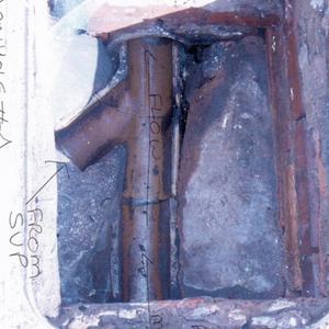

    What to do with manhole covers?
    Hi Richard hope you had a good break :D I think I need one as I have just read my whole post and can't belive what a total Numpty I have been!!! I am so sorry and if you dont reply I dont blame you at all. MH3 is the one that has the SVP going to it :oops: :oops: - the others MH2 & MH3...
    Richard, I will try and explain with pics, try not to leave you more confused. After double checking for the third time - SVP goes into MH#1 honest :oops: This is what I was saying about introducing a rodding point outside of the new room. Hope this is self explanatory. manhole...
