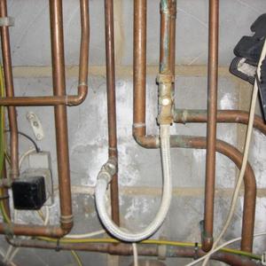

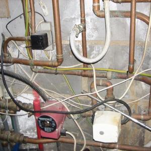

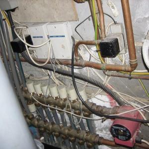

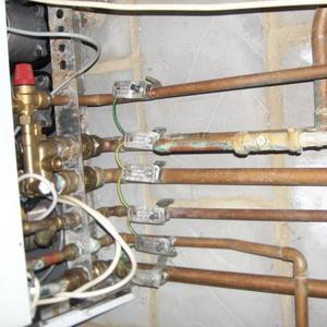

    Replacement combi for UFH installation help needed LONG POST
    So, would that 3PV be a blending thing then? Are those white doodahs powerheads? if so, presumably a number of them would be controlled by a single stat - there is an upstairs and downstairs one. If that is the case, I can just quote for two new programmable stats, a new pump and replacement...

    Thanks for the help so far. Hopefully i have uploaded the photos below. The layout of the boiler from left to right is:- GAS DHW DCW FLOW RETURN PRESSURE-RELIEF If this looks blindingly obvious to anyone, please shout out! Ta
    Doesn't seem to be a blending pump. I've asked the customer to take some photos, I'll post them up as soon as I get them.
    Just spoken to WB and the 42CDi puts out 240V so problem solved - thanks for your help lcgs - I was making it more complicated than it actually was!
    Aha, that would work (and make more sense) if the secondary pump was serving both zones and would also overcome the problem of firing if ANY zone valve opened - this is assuming that the boiler outputs 240V to grey or whatever colour isn't the orange one.
    First of all, I know nothing about UFH, never fitted, modified, repaired or specified it. I now need to quote for a combination boiler replacement and there are a few things that do not seem right about the existing setup and I need a bit of advice. Currently there is a Worcester Bosch 350...
