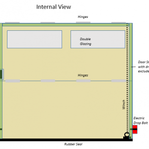

  1. J
    Build your own garage door - hanger style
    I did consider sliding doors, that was the first option to be honest. We had some quotes and the first thing that we were told was that the warranty would be null and void if I were to be riding my motorcycle over the tracks :-( . Then my wife noted that this type of door didnt look like a...
  2. J

  5. J
    I agree, but my wife has said no based on aesthetic reasons. Apparently our house is already ugly enough, without having a roller door on the garage :-)
  6. J
    Hi All, I need a garage door for a single garage that has been converted into a room. My use of the room is going to be a little odd - essentially I want to use it to house my motorcycle, tools etc, but also have it as a study. I therefore want the following: To use an absolute minimum of...
