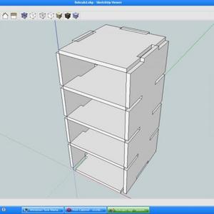

    MDF carcasses to support fish tank.
    OK. The back panel was going to sit inside the 4 edges as opposed to on their edges as I felt this provided further resistance to the downward pressures and also helped to prevent the shell from tilting. I did a mock up of one design (all in 3/4" including shelves) in Google Sketchup, here...
