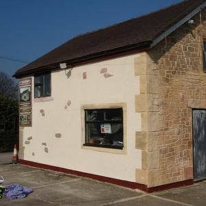

  20. O
    Pimp my pebbledash
    Had the Deco guys in last week to re-invent render on our garden centre office. The old render was bad and looked dull, I think its great now. Only took two days and looks like stones (no not cladding), the man did all this by hand with a small carving tool bRill :wink: These...
