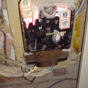

    Well, they arrived 3pm and were done for 4:30pm, fitted a grey plastic Henley unit. 80A fuse. Didn't convert to PME just fitted an earthing terminal and attached some type of clamping. Interesting that they linked the earth to what I know is now my neighbours feed, makes me wonder if our...

    Phoned YEDL today as had a day off, they weren't interested about a rusted cutout, but as soon as I mentioned a 'tarry substance' they booked it as an emergency. 2 hours later, they've been to inspect, confirmed a looped supply, opened cutout... "Yeah, that's been burning..." Will be...
