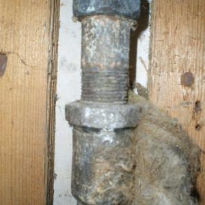

    my mains water seems to be 27mm pipe?
    Here you go ... This is the rising main (coming out of the ground, at the edge of our living room) and the (leaky) stop cock attached to it above. The pipe then goes up in to the loft (we're a bungalow) and crosses the property to the kitchen. This one shows a close up of the...

  7. D
    It's quite discoloured, but I'd say it's gun metal grey. The pipe comes out the ground vertically by about 5", then has a sort of bulbous bit ending in a nut, and that's where a threaded pipe goes in (the stop cock is connected to this part). So do imperials quote the internal diameter...

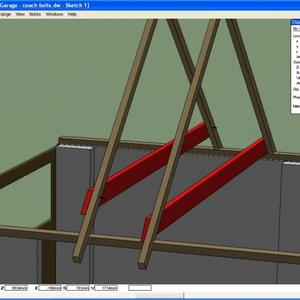

    How do I manoeuvre joists up to existing rafters?
    Thanks everybody! I've decided to nibble off as much length as required to finally be able to get on to the wall plate. Take a look then and decide if the overlap is sufficient. If it's not, then raise the joist up till it meets the rafter and affix with coach bolts.
  13. Options for fitting the joists
    One joist on the wall plate. The other just has been cut to a length that fits inside the wall, and then raised up to meet the rafters
    I think I see what you're getting at WestmidsChippy ... the bit I'm getting lost at is where you say cut the joist 10mm shorter than the span. This is probably caused by my ignorance and unfamiliarity, so sorry about that. The reason why I'm confused is that the joist is going to have to sit...
  16. D
    Thanks for these suggestions guys - appreciate the help. And I'm loving your workshop big-all !! Take a look at that long window on the facing wall of my model - there's really no blockwork above it, just the wall plate! And I think that gives me a big problem because there's nothing for...

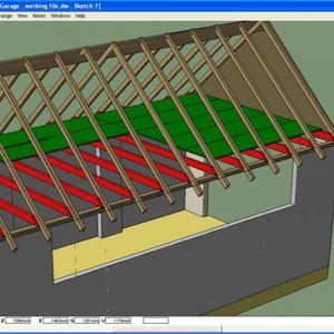

  17. D
    I have a garage that has rafters but no joists. It's been like that forever (well, since before we moved in, anyway). The roof has asbestos tiles covering all of it. I want to add joists to stop roof spread and to provide some storage space - see the picture: it's the red and green that are...
  18. Sketch showing joists + flooring
