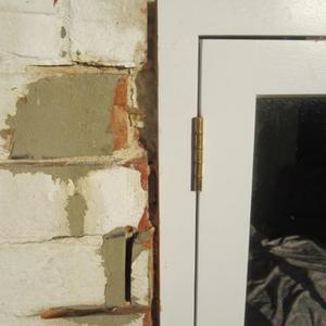

    Filling an external 20mm gap between window and brickwork
    They have done a first class joinery job, and we are very pleased with the windows. Of the 14, eight were straightforward. Tthree we are not entirely happy with:- They replaced Crittall windows, and they made too big a rebate on the inside, so had to close it with a hardwood trim; also, they...
    Thank you for your response. [/url] That's *this* thread ;-) In hardwood, I guess; with mitred corners, etc.. Mortar would be easier... or sealant. But not so neat, maybe. That's another problem - the windows were spray-painted, in a greyish shade of white.
    Yes. They are joiners, not window fitters. Well - not exactly... They haven't been paid in full yet ;-) They did a great deal more than expected, and I said I would finish off the making good. One wall was previously uPVC-clad; when they came to measure up, the battens were still in...
    They've made us some nice new hardwood windows to replace the uPVC, but there's a 20mm gap between frame and brickwork. These gaps are filled mostly with foam, but how should I seal them on the outside against the weather? I thought of using lime mortar, but that would a) crack, and b) not...
