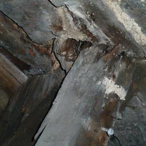

    Broken Ceiling Joist
    I didn't know you could do that. Thanks for letting me know. I've updated the first post to include the images.
  2. T
    OK, that's good to know about the acrow props. Thanks. The emergency order has been postponed! I think I will get a moisture reader and check the moisture of the joists. The joists aren't soaking wet, but it's difficult for me to tell much more than that by touch alone. I think the next...
  3. T
    Hey, thanks for the quick response. I'm not sure it the damp is historic or not, which is part of the problem. I've sorted out the rendering, but I don't know whether the parapet gutter is causing any issues. Given that the neighbour has the same problem with his joists, but hasn't had any...
  4. T
    Hi, We have a Victorian terrace house. He have been taking down the ceiling in the front room on the top floor, as it was bowing and needed replacing. We have taken off all the plaster and laths, and have now realised that one of the ceiling joists is broken. It is broken right at the...
