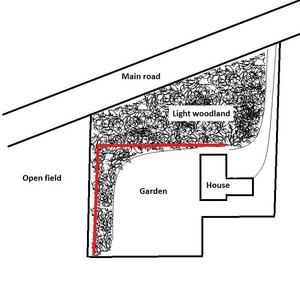

    Sorry, just to clarify, on the previous siteplan the proposed fence is shown in red

    Thanks Richard, I feel for you and your irritating traffic noise at night - sometimes the occasional car is worse than continuous traffic. I understand what you say about a small 'noise free' area, I have considered this. I have attached a rough site plan, not to scale. I would guess that my...
  16. Siteplan
    Siteplan
    Road noise barrier shown in red

  18. B
    Traffic noise reduction - which type of fence?
    Thanks Richard, and seege. Richard, I am aware of the 2m PD limit, may try to push this a bit as the site is completely hidden from neighbours etc. Seege, what you say is interesting re wavelengths. I imagine trying to stop very long waves (55ft!) is the most difficult. The mats you mention...

    Thanks for the replies guys. I want an L shaped fence running along two adjacent boundaries of the almost square plot, as the road runs at an angle across these two sides. Each side is about 30m so it's a 60m run altogether. I'm well aware that this could be like having a bad night at the...
  20. B
    Our house is well set back behind a strip of woodland from a busy road but we want to put up a high fence maybe 2.4m to further screen off traffic noise from the garden. Anyone any experience of having a fence installed for this purpose? Would a concrete panel fence be much superior to a heavy...
