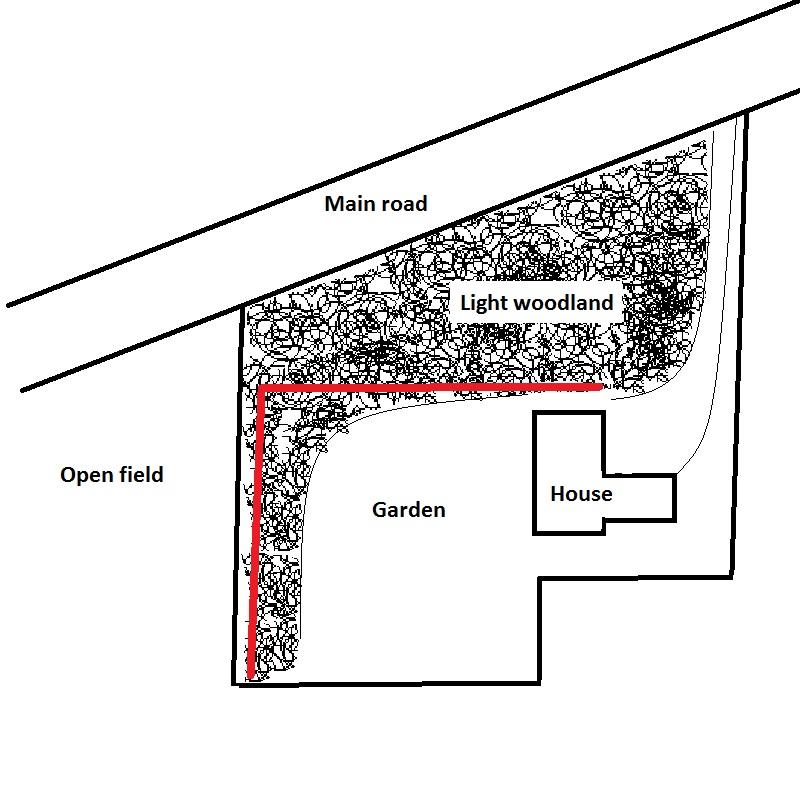

I have attached a rough site plan, not to scale. I would guess that my house is 30m from the road. I'm surprised at how much noise seems to go straight through the woodland, although it is fairly lightly wooded.
Fencing contractor is visiting tomorrow, I'll be interested to hear his opinion. Doubtless it will involve lots of money :(
Sorry, just to clarify, on the previous siteplan the proposed fence is shown in red

Is the woodland yours? I would start by putting a fence/wall as close to road as I was able.

The woodland won't do much, to be fair. especially if it's light. If you can see through it you can definately hear through it. They will give some very slight degree of diffusion.
Noise from traffic is a summation of loads and loads of different frequencies. conversly a flute has few harmonics above a fundamental frequency. a sine wave (sounding similar to a flute, ringing in your ears or the sound with the girl with a chalk board on the telly before broadcasting kicks in in the morning, pre digital switchover) is the building block of all sound. a cymbal has many sine waves over it's fundamental frequency meaning its hard to denote a pitch. its more like white noise/static/traffic which covers the whole audible spectrum. The reason you are hearing the mid range most strongly is because this is where the ear is most sensitive. you're talking around the 1khz to 6khz region.
Low frequencies are more subject to diffraction, a phenomenon of wave motion that causes them to bend around a precepice or barrier. Thats the main reason that you will find it hard to remove them. Similar to standing in the shadow cast by a wall in the 11am sun, you are in an acoustic shadow when close to the wall and out of the shadow when you step away from it. This is why richard has advised that the wall should be close to you or the source or both.
There's a 12ft wall that separates my neighbourhood from the A12 and a footbridge that crosses it. Makes for an interesting real life example if you can find anything similar to you. just listen to how the sound changes from the bottom at street level as you walk up the steps onto the footbridge.
Essentially short of building your listening position into a soundproofed floating box the best you can realistically hope for is to this effect... make a recording of the traffic, play it through your hifi and leaving the volume the same, turn down the high eq and knock back a little of the mid.
Rule of thumb would say, Big is good - height and width, as it will lower the threshold at which sound diffracts (starting at the top of your hearing range and working down) Hard and heavy is good as it will reflect higher frequencies better. suspended helps as the absorbtion will be greater at lower frequencies if there is a bit of give in the barrier. lastly layers work well as sound loses energy when it crosses mediums and the layers if fixed firmly to each other stops the wall vibrating so much like a drum skin.
