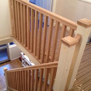

  9. P
    Smallest Gap Between Spindles
    Finally got round to putting the new rails and spindles in. Went for a 75mm gap in the end..... after a hell of a lot of time spent on the calculator and drawing lines on the baserail to check, holding up spindles etc! Still need to fill, sand and paint the newel posts..... Before...

  13. P
    thanks gents. That was my assumption, the old Victorian ones would go down to the step but with a riser you might get away with it. I'll put a couple up temporally and see what they look like before I decide. Don't want to cut all the fillets and then realise it looks naff! :-) Cheers...

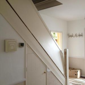

  14. P
    Hi all, Going to be installing a new handrail, baserail and spindles on our staircase as currently it's a panel and looks terrible. From reading what the website says where I ordered the wood it says to have two spindles per tread. Measuring it all out the other night it makes the spindle...
