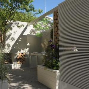

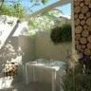

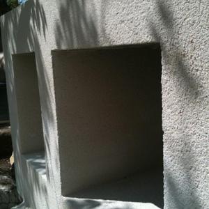

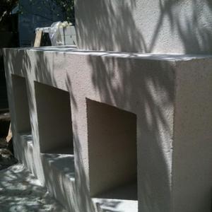

    weber onto block, middle one is a fire, either side are log stores
