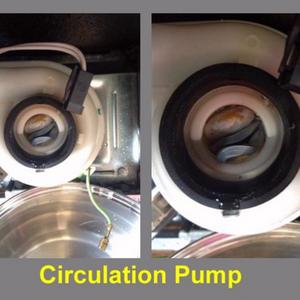

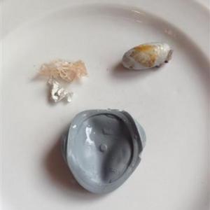

  4. andyr123
    Whirlpool ADP7406 Dishwasher top spray arm not moving around
    had the recirculating pump apart today and found this: So no wonder the arm wasnt going around, not enough force of water going through it. Wish now i checked pump first before ordering a reconditioned spray arm - ah well you live and learn

  8. andyr123
    Hi there just become owner of a second hand Whirlpool ADP7406 Dishwasher. Seems to work fine except for when I opened door quickly I noticed bottom spray arm was going around but top arm was not moving. As a test I positioned both spray arms in same position, closed door then opened up the door...
