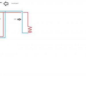

    Open vented heating issue
    Nope no vessel or non return. I can see all pipework its all exposed, the sketch is the layout of the pipework and how it is. I assume no one came across this before.. but its weird that the first post or so, say whats wrong with it???
  2. S
    Yes but being half inch does this make it unsafe.. as its accessible should i change cold feed to 22mm.
  3. S
    What about expansion.. like is this system ok to use..
  4. S
    No the sketch is all thats in the heating system.
  5. S
    System was drained to make some changes and wondering will this affect filling back up.. yes but its only 15mm for cold feed..
  6. S
    but there is no vent pipe??
  7. S
    Hi i was looking at a ch system today, its fed from tank in attic and using old potterton primaf boiler, problem is... it has no vent pipe over the f&e tank... and the feed from the tank is only 15mm. I will try attach a sketch now too..
